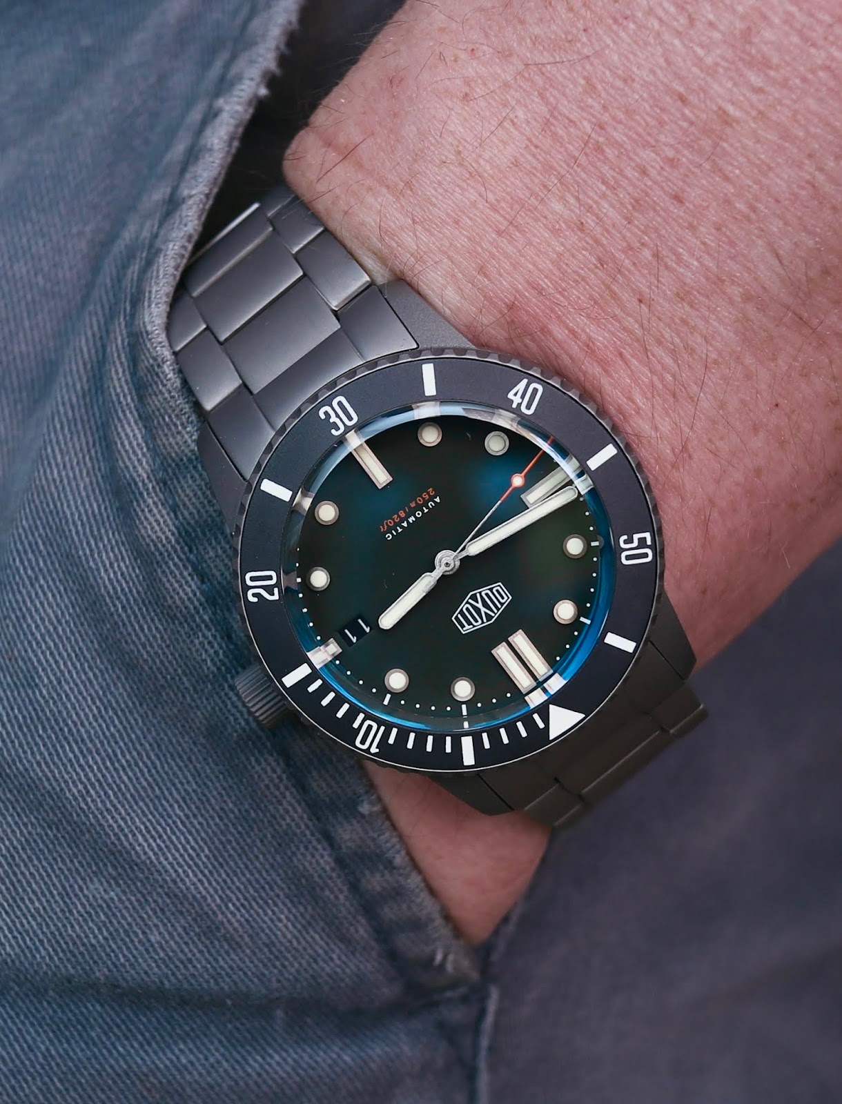

The case of the Forza presents many of its issues. There is nothing wrong with the aesthetic design of the case, but the proportions are jarring at first. Let’s call it tolerably stumpy. We’re talking about a 39mm diver that is 14.5mm thick. The height on my wrist was one of the very first thing is noticed about the watch. It’s just awkwardly tall. And though I could not will the watch to slim down, but I did get used to it as I had the watch on my wrist throughout the day.
The entirety of the titanium case (along with the bracelet) features a satin finish. However, I noticed that the tone of the case is different from that of the bracelet, which is different still from that of the clasp. That’s a pretty big (though in some light hard to see) miss in my book. The case features a bevel on its bottom edge that travels from tip-to-tip of the sharply-curved, slim 20mm lugs. A simple screwdown crown ensures 250M of water resistance, which is totally adequate, if a bit unusual, as most divers are 200M or 300M. The crown is slightly stiff when being unscrewed, but entirely functional—if anything, this may make you feel like it’s more secure; a Duxot ‘D’ graces its end.

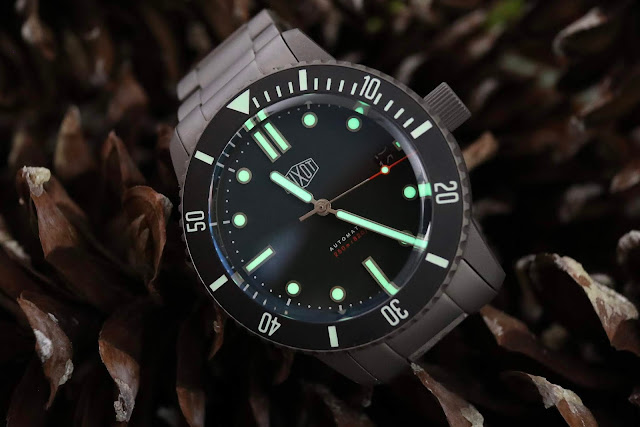

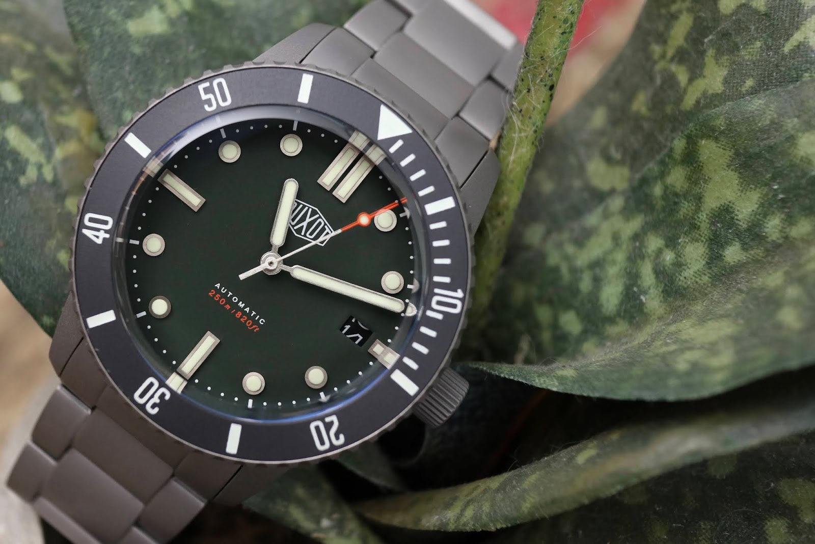

Let’s talk about that dial. Under a sapphire crystal lurks a deep green (the actual color name) matte dial. The lume here is big and bold and lovely. But my favorite part is the applied indices. The flat lume plots sit atop what appear to be brushed metal markers. It’s incredibly subtle, but amazingly executed and adds depth and texture to the flat green dial. The capsule shaped hands feature the same finishing as the indices, while the lollipop seconds hand features an orange end to match the orange dial text. The date window is at 3 o’clock and is inoffensive, if it’s anything at all. Taken as a whole, the dial is highly legible with a pleasing balance of color.

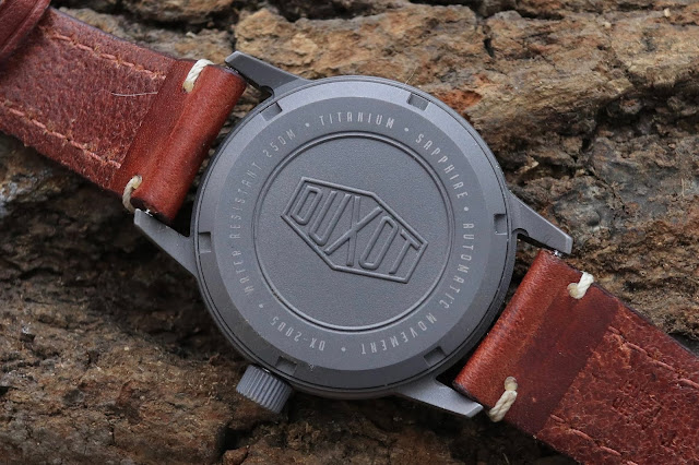

The screwdown caseback features a crisp, clear logo with all the words telling you all the details of the watch. It protects a Seiko NH35, wherein we find the culprit of the watch’s thickness. The NH35 is a well-known movement that’s reliable and easily serviced. But it’s also 35% thicker than its Miyota counterpart, the 9015, which offers a higher beat and longer power reserve. However, Duxot may have opted for the Seiko simply because its much cheaper (which I’ll come back to).
