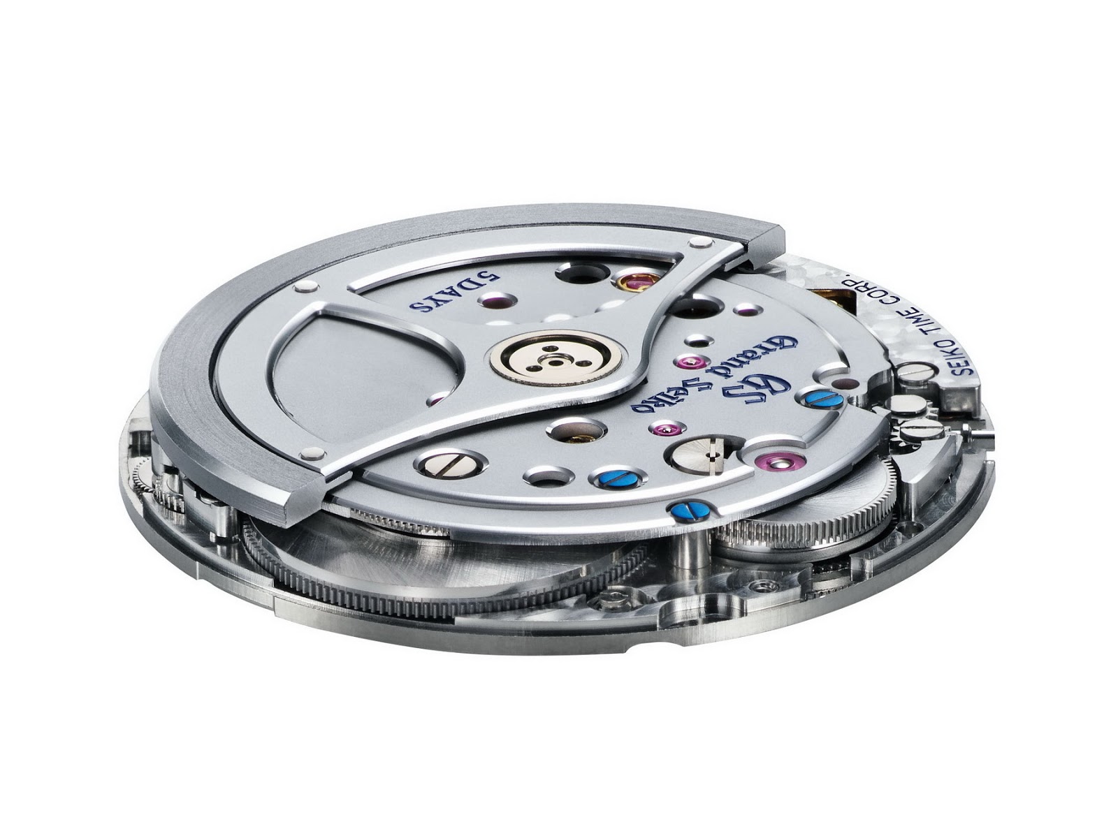

Twenty years on, Grand Seiko’s Spring Drive remains one of their greatest innovations. However two decades is a long time so we should expect a substantial leap in technology which is exactly what the new Caliber 9RA5 offers over the outgoing 9R6.
Seiko say of the new generation Caliber 9RA5 that it takes Spring Drive technology to the next level offering enhancements in every aspect of its performance and finish. It is also slimmer more precise and offers an even greater level of autonomy.
By comparison the Caliber 9RA5 delivers a five-day power reserve over the 9R6, an increase of 60%. Its monthly precision rate has risen from ±15 seconds a month to ±10.

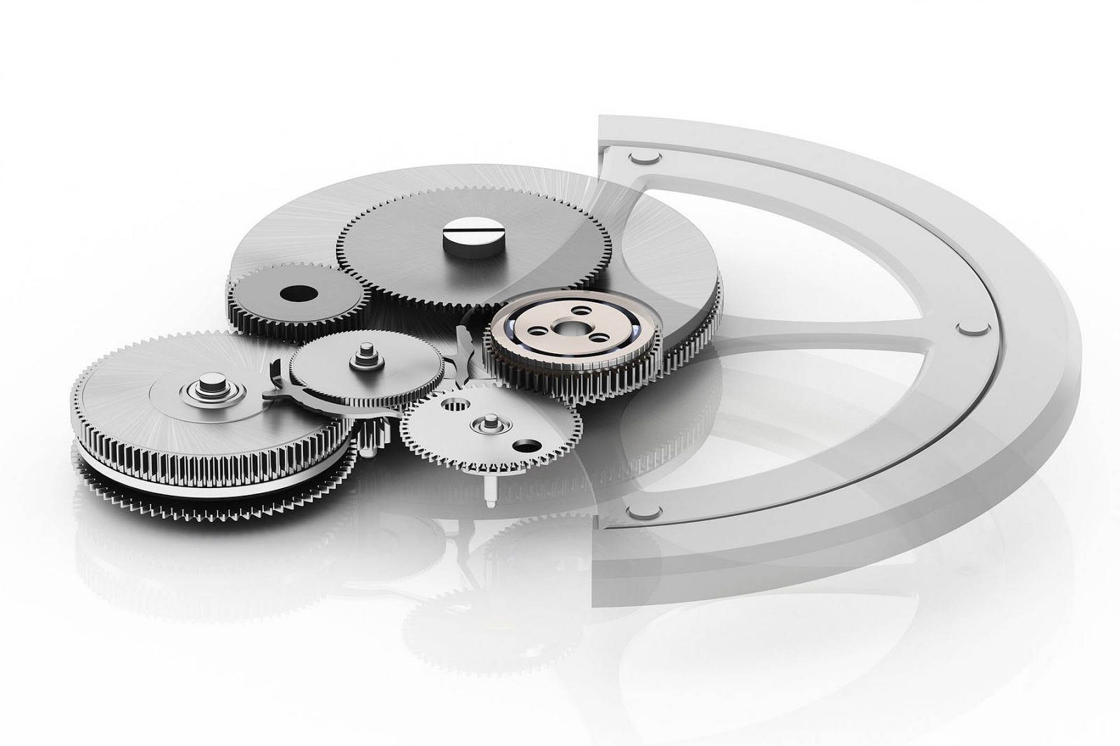

Thanks to what Seiko call the “Offset Magic Lever” the movement’s depth has been reduced from 5.8mm to 5.0mm all the while maintaining the same high degree of winding efficiency in addition to the speed of the date change being greatly increased. Tbh they had me at magic lever!
The caliber 9RA5’s thin profile is made possible by the re-design and re-positioning of said Magic Lever which was developed in-house as far back as 1959. The Magic Lever boosts the efficiency of the automatic winding mechanism by using the energy created by movement of the oscillating weight in both directions.
For the new caliber, the “Offset Magic Lever” has been positioned away from the center of the movement reducing its height.
This was achieved without the loss of any winding efficiency. The stem and crown are also positioned towards the back of the case to lower the center of gravity and achieve a more comfortable fit on the wrist. So I wonder if this means this GS Diver actually has a slimmer case?

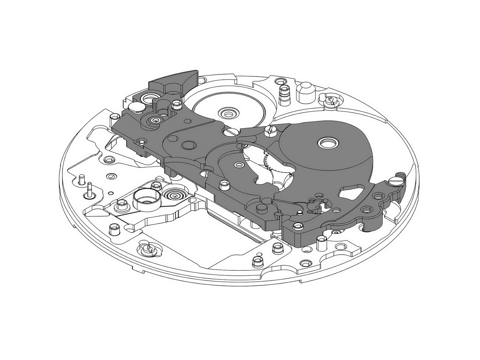

The Caliber 9RA5’s new slimmer figure also boasts enhanced rigidity and shock-resistance thanks to the new layout of its gear train towards the center of the movement and a central bridge that holds them together. This One-piece Center Bridge achieves a shock-resistance that meets ISO standard for diver’s watches.

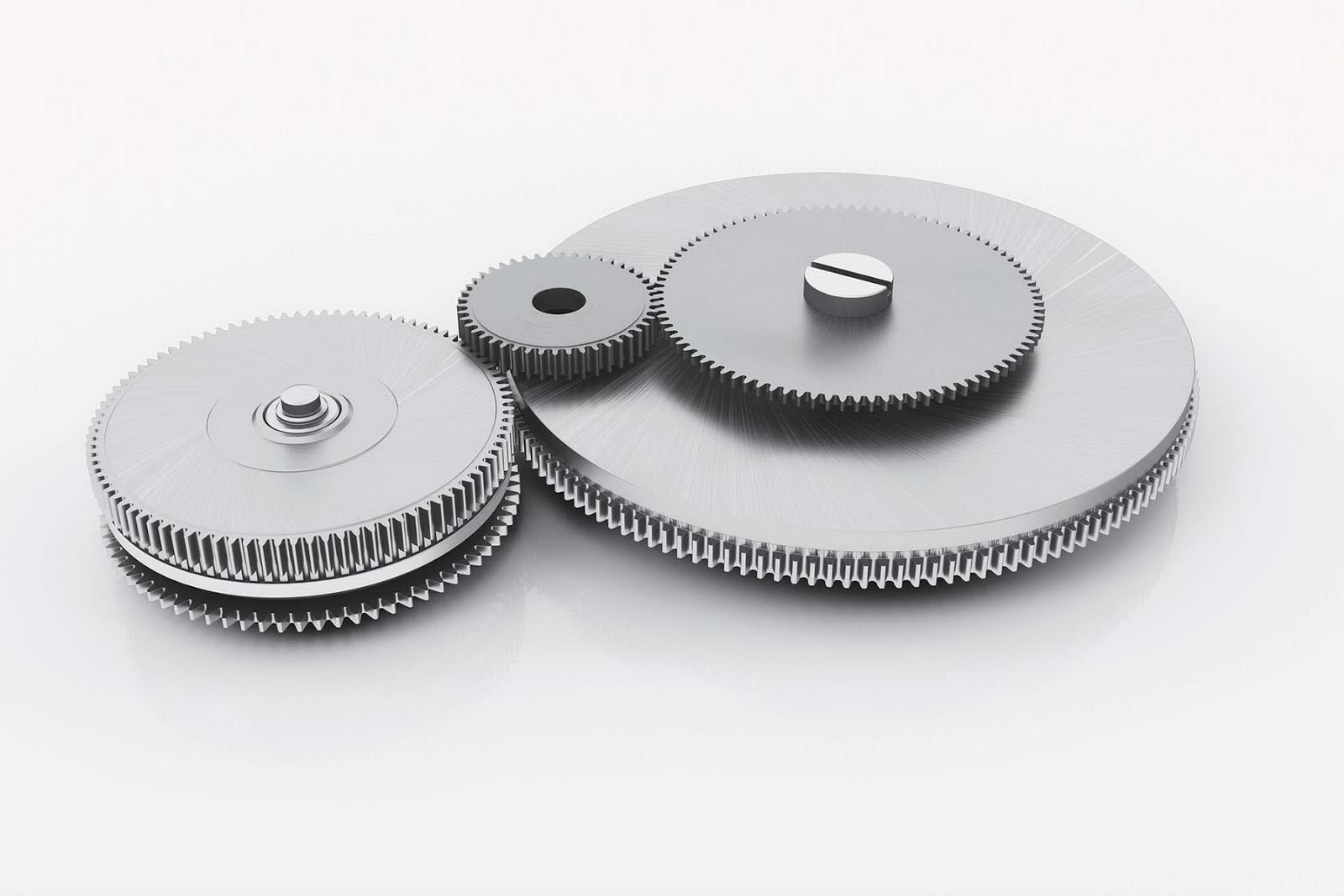

The movement incorporates two barrels (one large and one small) that deliver a power-reserve of up to 120 hours. They are different sizes so as to deliver the torque required for the five day power reserve while optimizing the use of the limited space within the movement.

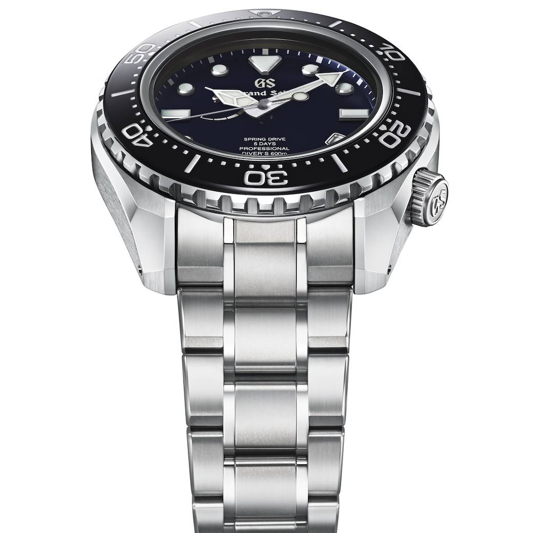

As a testament to just how capable it is, the first timepiece to be powered by the Caliber 9RA5 is a professional diver’s watch. It has Helium and water-resistance so that the watch could be taken on a SAT (saturation) dive to a depth of up to 600 meters.

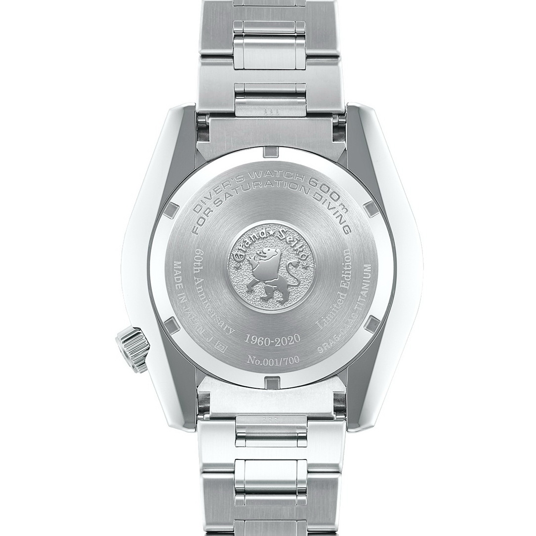

The case has been crafted from high-intensity Titanium, which is 40% lighter than steel and more impervious to scratches. The power reserve is at the 10 o’clock position and the indicator is divided into five parts to show exactly and clearly how many days of power are left.
The case, crystal and bezel are all designed for easy and safe disassembly for the maintenance that a professional diver demands.
SLGA001 is presented in a special Grand Seiko 60th anniversary box with an interchangeable blue silicone strap. It will be available worldwide as of August as a Limited Edition of 700 pieces. MSRP in the EU is 11,500€.
