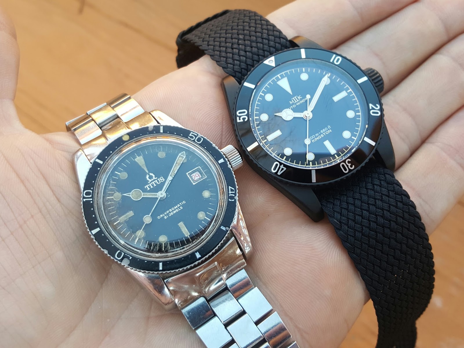

First, decide on what style of watch you’re making. With the Moflake already being established, I only want to make a modest update. A good friend, DH (@dirtyharrie on Instagram) hunted down a beautiful Canadian Tudor Milsub.
Instead of the traditional square markers paired with snowflake hands, it has the more traditional Submariner dial layout. This is the direction I’m going to take the Moflake. Use your choice of software to layout your design. Use white for the details where you want the brass plate to show through. This is the negative-relief. Ink-jet printers don’t print white. The white spaces will allow the brass dial plate to show through the decal.

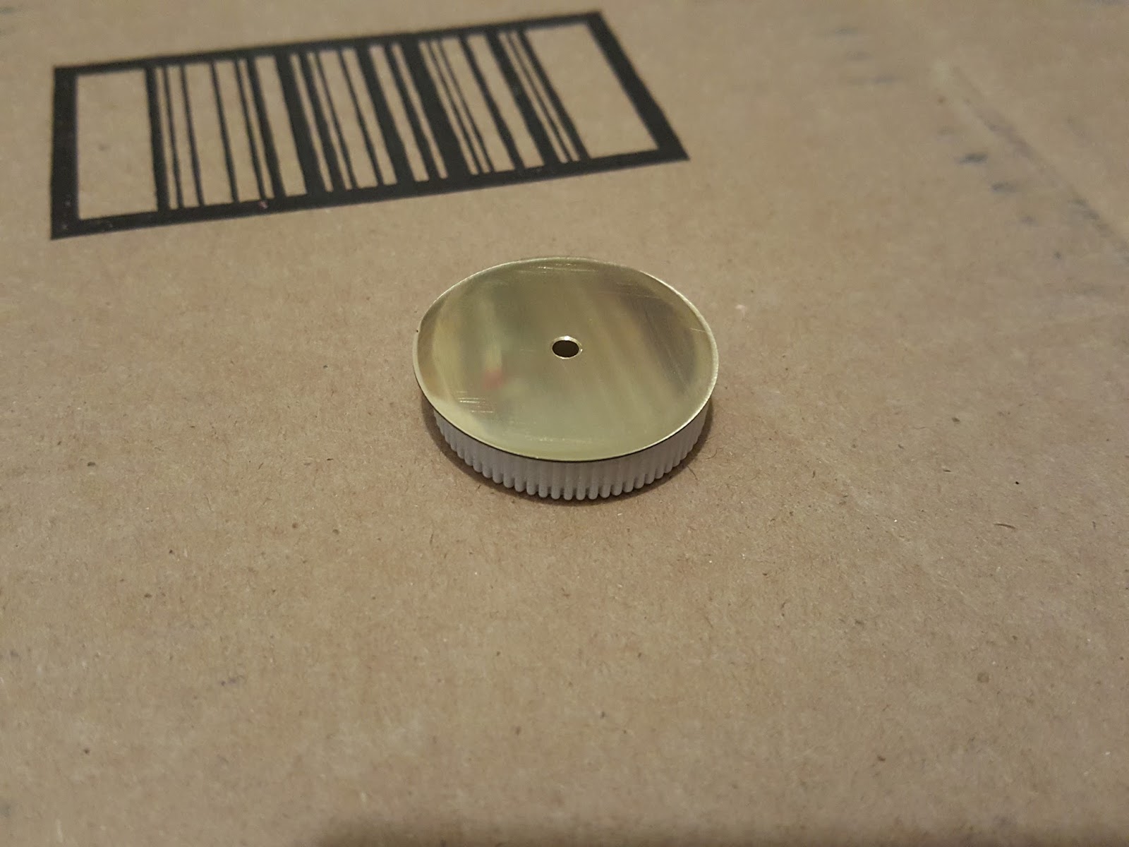

Now that the decals are prepped, let’s begin prepping the dial. Find a donor dial that you will be using. Put small drops of paint on the dial feet, and touch the dial feet to a piece of cardboard. No punch pin holes in the cardboard. Set the dial feet into the pin holes. This will hold your dial in place. Make 2 of these cardboard holders. Mark 3-6-9 and 12 o'clock for your reference points on one of the pieces. This will be your template for applying the dial. The second holder will be used to keep the dial in place while you sand off the printing. I use 300 grit paper to remove all the paint and printing. Then I use 500, 1000, and 1500 to polish the plate. I then polish the dial with Brasso to remove any dust. Once you have your shiny dial plate, you will want to seal it with a thin layer of clear coat just like the decals. Brass can tarnish, and this will prevent you from having troubles with your dial in the future.

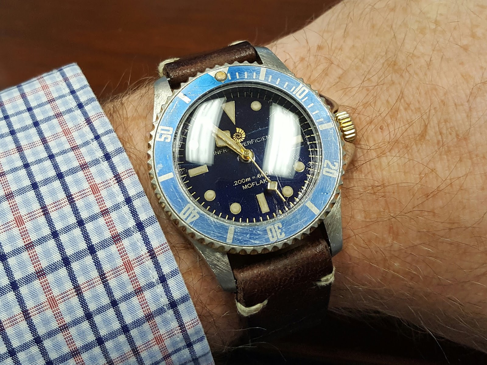

The dial is complete and lumed along with the hands. What’s left? Now you put it all back together, and wear the heck out of it. Roll credits…
