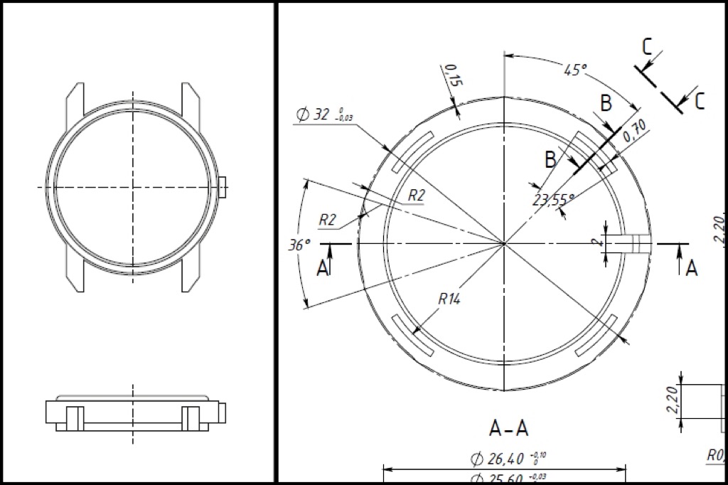

At this point, you probably have a clear idea of what your future watches are going to look like; however, there is a lot of work between a first sketch and proof of concept and the actual final design. To get that work done, you will need a professional designer. Not only will they be able to help you fine-tune your original idea and often improve on it a lot, their main contribution will be putting together the vector files (.ai or .eps) that you need for a high-quality printing of your dials. Doodling it by yourself on Photoshop and saving your work as a JPG is not going to cut it.
But perhaps even more importantly, you need somebody to design your watch’s blueprints. It is not enough to have the case drawn front, back and side. A watch’s blueprints are dozens of pages of extremely accurate specs for the factory to work on, and you cannot do without them. That is the job of an industrial designer, and they probably won’t be the same person that is going to design your dials.
For Kosmos 24, we worked with a young Russian graphic designer that we personally knew and whose work we really liked. She hadn’t worked with watches before, but when it comes to designing the face, it’s okay, what matters most is the person’s artistic talent. For the blueprints, however, we decided to work with someone more experienced and found a master watchmaker called Konstantin Chaykin. Even though he usually works on extremely high-end luxury watches (above the 100.000$ mark), he agreed to design our watch and draw the blueprints for us.
To give you an idea of how far we were from a professional design when we started, here is the very first proof of concept for Kosmos 24, next to the final designed it inspired:
And this is what we thought counted as blueprints, next to approximately 10% of our actual final blueprints.

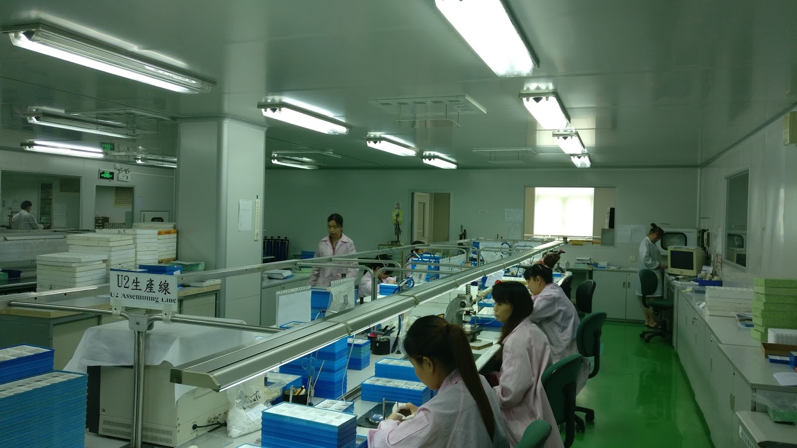

Now that you’ve got your watch figured out, it’s time to find a manufacturer. Your main options are Switzerland, China, or the rest of the world. While a few other countries, such as Japan or Germany, may have a viable domestic watch industry, the Swiss and the Chinese are the most accessible for small brand production.
The right answer will largely depend on your marketing positioning. If you brand has a very strong local flavor and you can find a small watch assembly workshop in your country, it may be worth the extra money to have your timepieces manufactured there. But remember, unless you are producing very high-end watches, most of the parts will be made in China anyway, and only final assembly will be done in your given country.
The Swiss are well known for watch making and this is reflected in their prices. Whether you decide to pursue production there may depend on your brand marketing. The Chinese make perfectly good watches for many reputable brands. In fact, I'd say any watch under $400 (and many even more expensive ones too!) is at least partially made in China, so unless you really cut corners, you will get good value for money if you go with a Chinese manufacturer. Just keep in mind that if you are going for a high-end luxury product, many buyers will expect to see "Swiss Made" and the dial and may not accept anything else.
Beyond the PR side of the question, the real risk you are taking when looking for a supplier in China is that you will likely not know much about them. Do NOT just pick a supplier at random off of AliBaba! There are many trustworthy suppliers out there, but also many who will disappear after you wire them your money. If you are going to work with a Chinese partner, you should do it properly. Getting in touch with your country’s Embassy in China, your local Chamber of Commerce or the Chinese Embassy in your home country is a good first step to avoid getting conned. Also, I strongly recommend visiting your supplier in person. Get yourself a passport, a Chinese visa and fly there; it’s not that hard. It’s certainly easier than pretty much everything you will be doing for your project, and at least you’ll make sure that you are dealing with a real person, visit their factory and establish a good personal relationship. Also, you’ll get to say “I can’t come next week, I’ll be on a business trip in China,” and let’s face it, this sounds awesome.
Be aware that most Chinese manufacturers will often offer you the services of their in-house designers too, but this is not something I’d recommend. Design is all about fine-tuning, and tiny details, and getting back a hundred times to the drawing board. You need to be around, to see for yourself, and most importantly you need to be paying that person. Otherwise, it will start feeling uneasy demanding for a new version sometime around the twelfth modification of the original design. Keep it under control.
For Kosmos 24, we got in touch with the French embassy in Hong-Kong and took it from there, which eventually led us to our supplier, a small family company with over 30 years of experience. We loved the way they helped us better understand our own project, asked very insightful questions and overall were just incredibly helpful. We developed a good relationship with them and have absolutely no doubt that they will deliver excellent quality.
