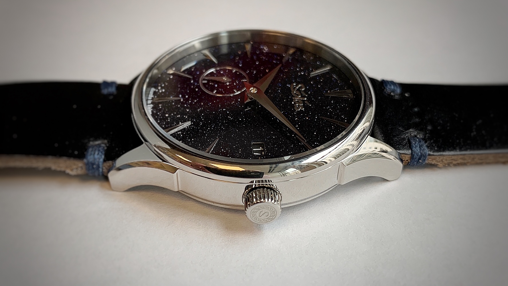

The case is a very wearable 38mm, 44mm lug to lug, and 9.8mm thick - almost thin enough that you’d think it was a manual movement. The case is extremely well finished with mirror polished surfaces throughout and curved lugs. The crown is well proportioned for easy winding and is capped with an engraved Sólás logo. Both the crystal and the display back are flat sapphire and show the dial and movement with perfect clarity. The thin bezel ensures that the Starlight has maximum wrist presence for its size on my 6.5” wrist. I did find the crystal to be a bit of a fingerprint magnet, but what flat sapphire crystal isn’t? The dial sparkles through the crystal regardless and catches your eye from any angle.
In choosing to use an aventurine dial to cap off the Starlight, Sólás chose to pursue not one, but two very difficult challenges within one watch. Adventurine is a very brittle material to work with and requires a backing plate, adding to the thickness of a watch. I found it readable in most lighting, but no lume means you’ll need to provide your own light source to read this watch in the dark. The markers and hands are well proportioned for the dial, and I like the touch of asymmetry the placement of the sub-seconds dial at 7 brings. The date window is my only quibble with the dial: the unpainted edge of the backing plate can reflect the date wheel printing, giving the date window an unfinished appearance.
