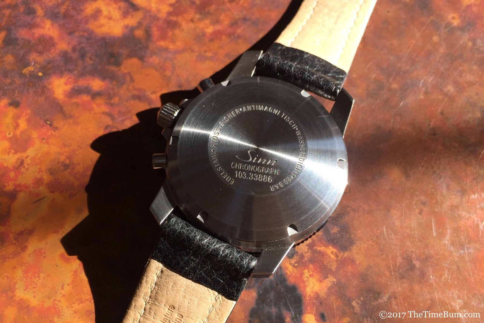

Sinn calls its 103 series "the traditional pilot's chronograph" and offers several variants and limited editions. Mine might be considered the value leader of the group: polished case, acrylic crystal, and leather strap. Unlike many aviation-inspired watches, it takes this function seriously, meeting or exceeding DIN standards for anti-magnetic shielding (4,800 A/m), water resistance (rated for 200m), and shock resistance (essentially, the equivalent of a drop to the floor). Far less common is its low-pressure resistant design that ensures the crystal won't pop out at high altitude.

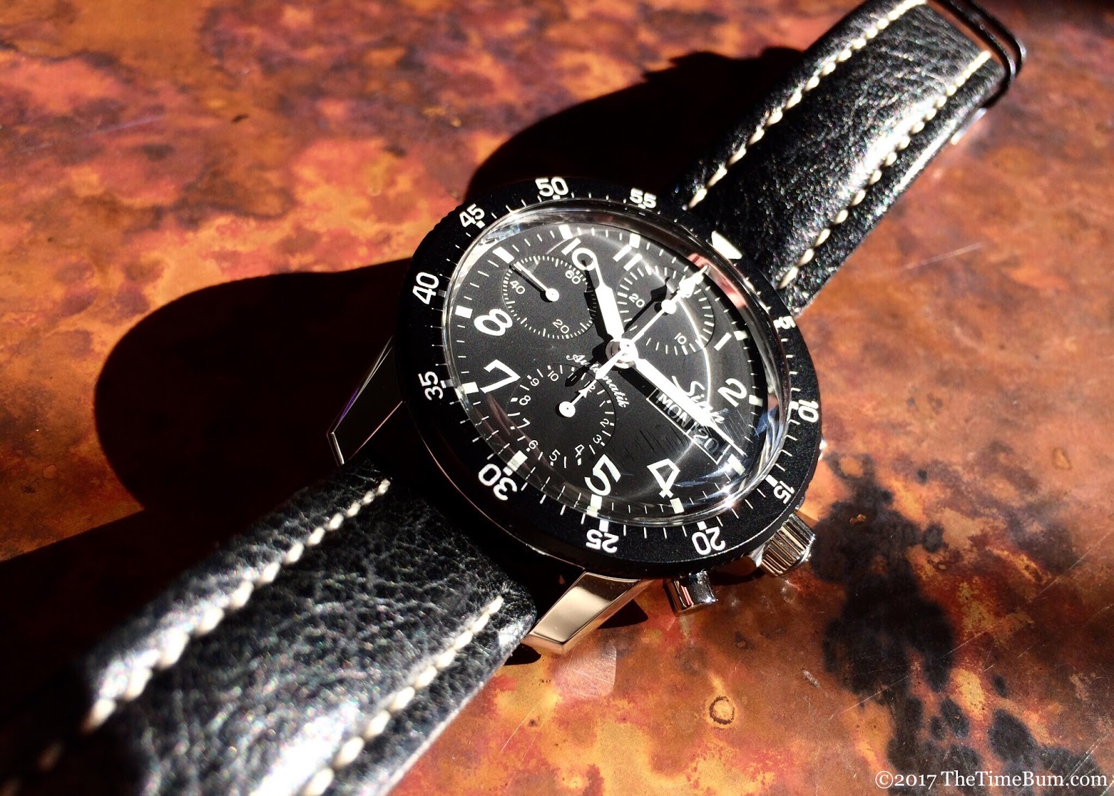

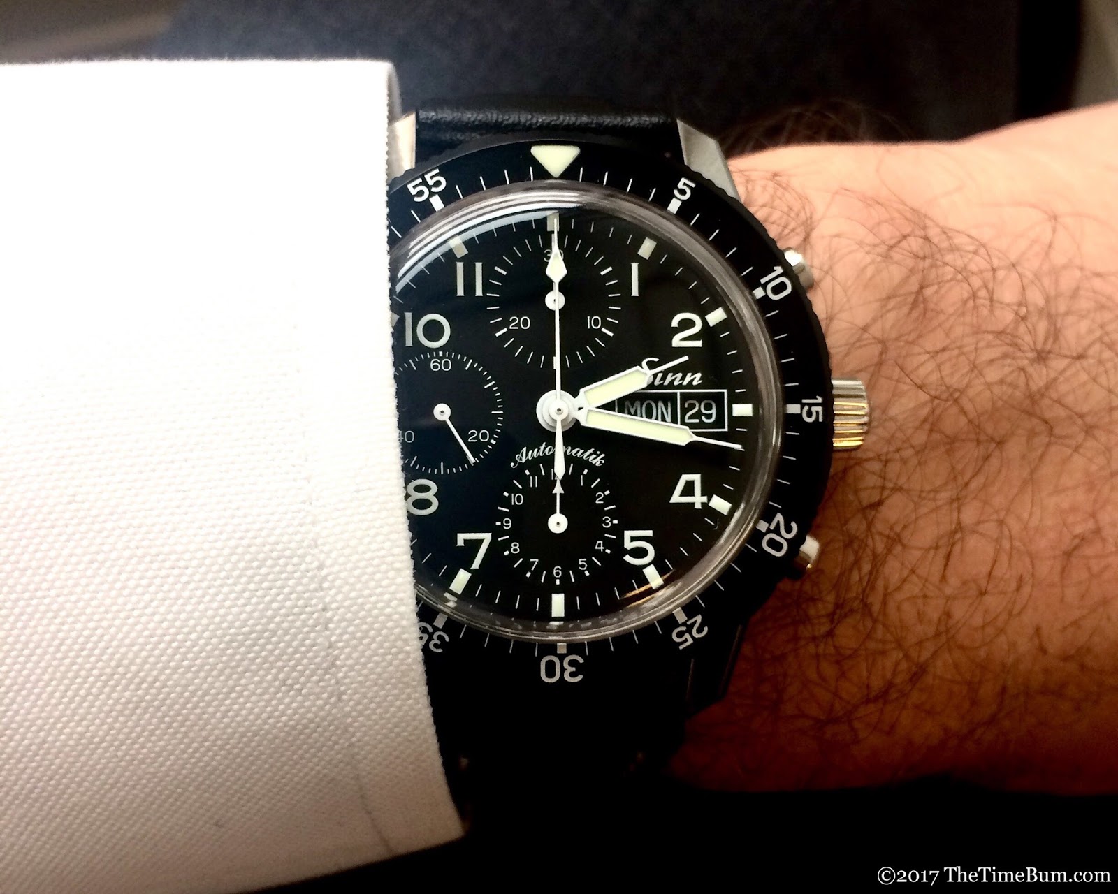

The case is just 40mm wide and 47mm long, which is a huge advantage for a slightly-built fellow like me. It has small The lugs are broad and angular, dropping sharply away from the barrel to create a more natural fit over the wrist than its otherwise flat profile might suggest. It is 15.5mm thick from case back to the top of the dome, although it appears to be slimmer. About 3mm of that figure is just the crystal. Viewed in profile, a matte black coating masks the bezel, so your eye first registers the narrow, polished case sides that bridge the lugs. Below that is a shallow brushed concave lip. Finally, the case back falls away at a shallow angle so that the flat area is only about the size of a penny. With slab sides and a flat back, the 103 would look like stout, but the 103's sculpted case and varying finishes are trim and tailored. There is much an aspiring watch designer could learn from this case.

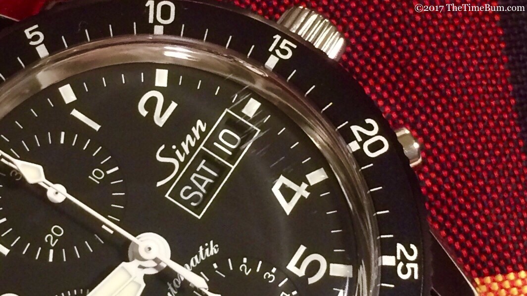

I love the tall acrylic dome. Some would ask why. After all, people gladly pay a premium for sapphire Sinn makes a 103 St Sapphire, and it is not as if there is any shortage of sapphire crystal watches at or even well below the 103's price point. If given the option, why choose plastic? Well, for starters, it looks cool. I dig the warm, heavy look and crazy edge distortion. Nostalgia plays a role too. Plastic domes were the norm 50 years ago so they look right at home on a mid-century design. Also, while sapphire is impossible to beat for scratch resistance, and acrylic is soft enough to scratch just by looking at it funny, it wins on impact resistance, taking hits that would shatter sapphire. Finally, acrylic is cheaper, never a bad thing in the Time Bum's eyes.
I put my convictions to the test by damaging my watch in the first three days. For the life of me, I have no idea how or where I did it, but I looked down and saw a row of ugly scratches down the right side. When I had a moment, I pulled out some plastic restorer and a soft cotton cloth. I know most folks swear by Polywatch, but I have been using a 3-part system by Novus. First, I rubbed out the deep stuff with Heavy Scratch Remover, then applied Light Scratch Remover to polish, and finished it off with their Plastic Cleaner to remove any residue. Was it good as new? No. If you look very closely or employ a loupe you can see the deepest of the lot is still lurking just above the date window. Acrylic will inevitably pick up nicks and scratches over the years. You polish out most of them, minimize the worst, and chalk up the rest to character. I'm good with that.

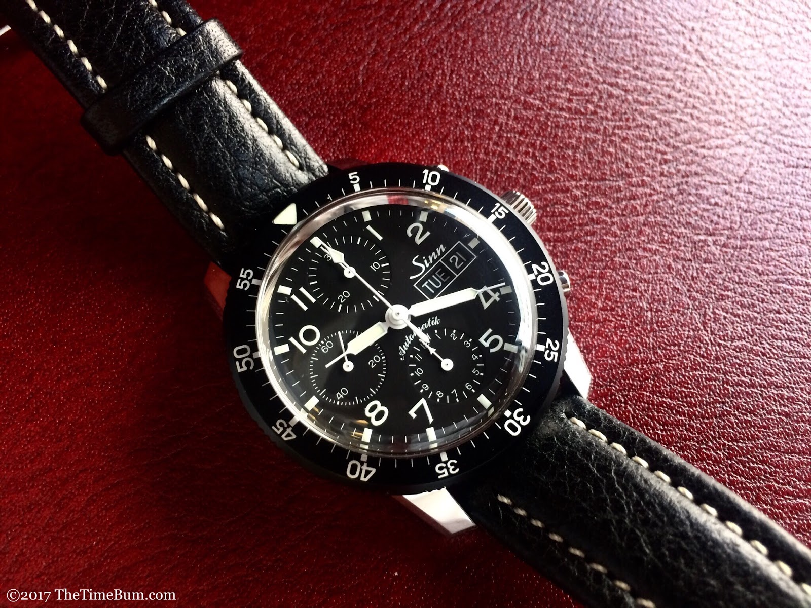

As mentioned above, the bezel is flat black all around. Shallow grooves above the markers provide adequate grip. The markers are printed except for a lumed triangle. A close look reveals a half-height index and fine-lined numbers that alternate size (larger tens, smaller fives). The bezel is bi-directional and has no detents. This is standard for pilot's watches but I was surprised at how little resistance there was. That said, not once has the bezel slipped out of position, so I'd chalk this up as more of a feature than a flaw.
The dial is packed with information but still clearly legible. Due to its modest size, the sub dials occupy a good deal of real estate, reaching nearly to the center. Along with the day/date windows, they displace the numerals in their quadrants but don't truncate any. Dial text is limited to the Sinn name at 3 o'clock and "Autotmatik" in stylized script, wrapped over the hour register. No space is wasted; everything fits. A spear-tipped sweep hand and syringe hands finish the face with the proper vintage military flourish. Lume glow is excellent. The hands, markers, bezel triangle, and second hand tip all go green in the dark, offering easy readability even with just a modest charge from indoor lighting.

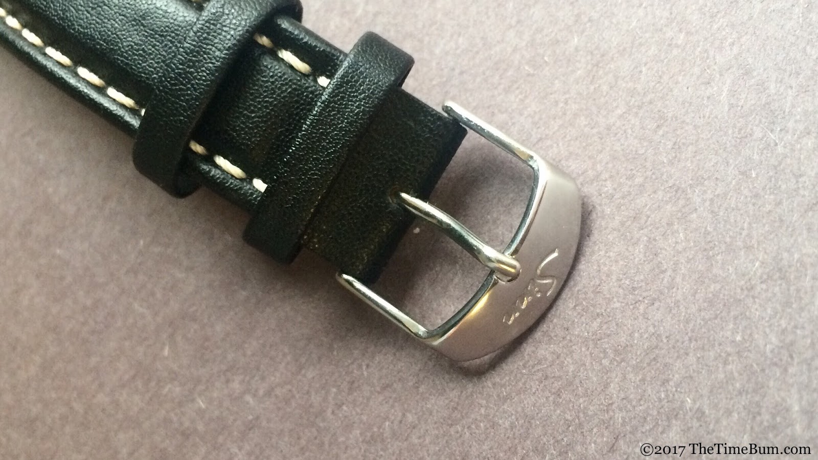

Sinn bracelets are top quality, but for a classic pilot, I wanted black leather and contrasting white stitching. I got exactly that on the 103, but the stock strap was just a tad long for me. Most standard straps are 70/115mm or something close to it. This one is 90/115mm. Folks with bigger wrists will appreciate it; however, I ended up with an awkwardly long tail, so I swapped it out for Hirsch buffalo leather that fits the same 20mm lugs and accepts the same signed, 18mm pin buckle.
